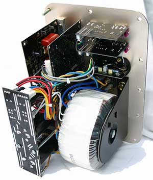

Early on in the design process, an all-analog amplifier design was considered--and rejected. Why? Analog amplifiers have only about 50% efficiency, so if the subwoofer required a 500-watt analog amplifier to drive a 12-inch driver in a large enclosure, it meant that the amp would draw at least 1,000 watts from the AC line. Unfortunately, there is limited access to total power from a house AC outlet. At the least, such a sub might trip the circuit breakers at peak output or cause brownouts and disrupt performance of other household electrical appliances, including your projector or TV.
The alternative to this scenario was apparent: a digital switching amplifier, because of its inherent high efficiency of 90%. Many existing subwoofers already use digital switching amplifiers because they are efficient, cool-running, lightweight, and relatively economical. But conventional digital subwoofer amplifiers have a severe limitation: no headroom. When a digital amplifier reaches it output limits, instant distortion results. And given that movie soundtracks and large musical works have sudden dynamic swings that demand sudden bursts of power, this didn't seem the appropriate choice.
The solution was to design an analog power supply (not a digital switching supply) that would give the digital amplifier plenty of headroom for large dynamic peaks. Additionally, output devices were selected for their ability to deliver huge amounts of current. The new design produces 600 watts with headroom to spare. Axiom also realized that an entirely new driver design would be required to handle such power and attain the design goal of deep bass response to 17 Hz with a maximum undistorted output greater than 110 dB SPL.

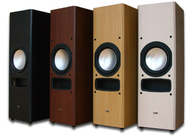

A massive 12-inch aluminum-cone driver with a 3-inch diameter dual voice coil was designed (the dual voice coil lowers the internal impedance to 1.3 ohms, so the digital amp can utilize high-current drive)(pictured left). In terms of deep bass extension, Axiom knew that total box volume vs. driver diameter still rule, so a vertical enclosure measuring about 46 x 15 x 17 inches was proposed. By combining the new driver with the application of a very long tuned port (3 feet!) in a large enclosure and the assistance of the XLF (Digital Signal Processing of the response), the desired bass extension to 16 Hz in an anechoic environment was achievable.

Some of the EP600's other characteristics are relevant: It weighs 100 pounds, and you can request it in a horizontal version so you can conceal it behind a sofa or put it away at one side of the room. And for those willing to accept just 2 dB less in maximum output (109 dB anechoic/120 dB in-room) and a bit less extension to 19 Hz anechoic and 15 Hz in-room, there is the Epicenter EP500, a somewhat smaller version with the same massive driver, slightly less power output (500 watts vs. the larger sub's 600 watts), and, at $1150, a price that's $600 less than the larger sub (the EP600 is $1750).
