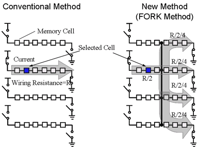

Mechanism of reduced electrical resistance in wiring for writing:
The resistance per wiring was reduced by 38% by adopting new wiring method which forks writing current.
*R/2+R/2/4=5/8R=0.625R: R= resistance of current method.
