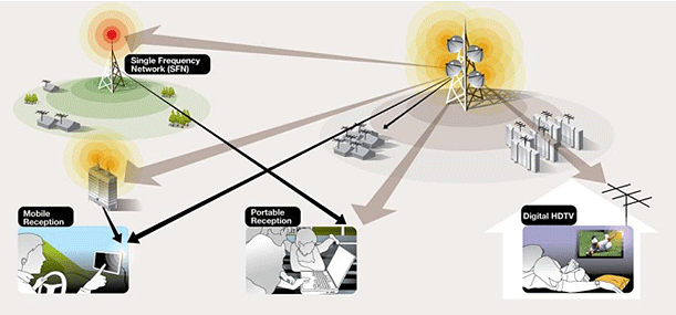

What is Advanced-VSB?
A-VSB technology builds on the current ATSC transmission standard to enhance the ability of receivers to display television broadcasts while in motion, both indoors and outdoors. It also allows broadcasters to include multiple "turbo-coded" streams within the current main stream, resulting in stronger, clearer signal transmission. In addition, A-VSB eases the synchronization of broadcast signal timing among different towers in a Single Frequency Network (SFN). SFNs can improve the quality of broadcast service by providing uniform signal strength throughout a service area, so that receivers can receive a stronger signal from a nearby transmitter and take advantage of the spatial separation of multiple transmitters to mitigate obstacles such as hills and buildings.
How does A-VSB work?
First, a broadcaster adds a specified Supplementary Reference Sequence (SRS) to the transmitted signal. A-VSB receivers use the SRS in order to remain locked on to the transmission-including both the main signal and extra turbo signal(s)--even when dynamic interference would normally disrupt a signal, such as when the signal is reflected by moving objects near the receiver. A-VSB also makes it possible for the receiver to stay locked on to the signal when the receiver itself is moving, such as when a viewer is traveling with a portable TV. Moreover, as Samsung will demonstrate again at NAB 2007, the combination of SRS and Turbo code makes reception possible at high mobile speeds, such as in a car or on a train, and in urban environments which have a large amount of interference reflected from buildings and objects. When implemented, this breakthrough will enable fully mobile TV services using the existing frequencies and facilities of broadcasters, with minor upgrades to their transmitting equipment.
For the first time at NAB 2007, Samsung will demonstrate a "half-rate Turbo" mobile reception mode using half the bandwidth of the previously demonstrated "quarter-rate Turbo" mode. Half-rate mode is targeted for highway speeds, rather than the faster bullet train speeds which quarter-rate mode enables.
Is A-VSB backward compatible?
Yes, broadcasters can implement A-VSB technology with no impact on legacy (non-A-VSB) digital TV receivers, which will ignore the added information in the signal while continuing to receive the main TV stream (e.g., High-Definition TV programming). In addition, as A-VSB technology helps broadcasters deploy SFNs to fill gaps in the coverage of their service area, owners of legacy receivers may find their reception quality is also improved.
