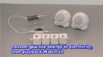

Test cells of this bio battery have achieved power output of 50 mW, currently the world's highest level2 for passive-type3 bio batteries. The output of these test cells is sufficient to power music play back on a memory-type Walkman.
4 prototype bio battery units (left) connected to Walkman for playback

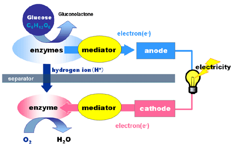

The bio battery mechanism
The newly developed bio battery incorporates an anode consisting of sugar-digesting enzymes and mediator, and a cathode comprising oxygen-reducing enzymes and mediator, either side of a cellophane separator. The anode extracts electrons and hydrogen ions from the sugar(glucose) through enzymatic oxidation as follows:
Glucose -> Gluconolactone + 2 H+ + 2 e-
The hydrogen ion migrates to the cathode through the separator. Once at the cathode, the hydrogen ions and electrons absorb oxygen from the air to produce water:
(1/2) O2 + 2 H+ + 2 e- -> H2O
Through this process of electrochemical reaction, the electrons pass through the outer circuit to generate electricity.

The test cells of these high-power, compact bio batteries have been fabricated using these three technologies. The bio battery does not require mixing, or the convection of glucose solution or air; as it is a passive-type battery, it works simply by supplying sugar solution into the battery unit. The cubic (39 mm along each edge) cell produces 50 mW, representing the world's highest power output among passive-type bio batteries of comparable volume. By connecting four cubic cells, it is possible to power a memory-type Walkman (NW-E407) together with a pair of passive-type speakers (no external power source). The bio battery casing is made of vegetable-based plastic (polylactate), and designed in the image of a biological cell.
