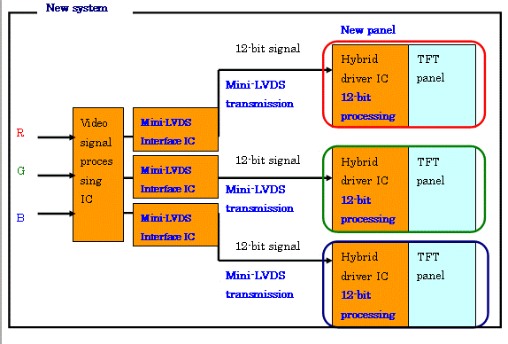

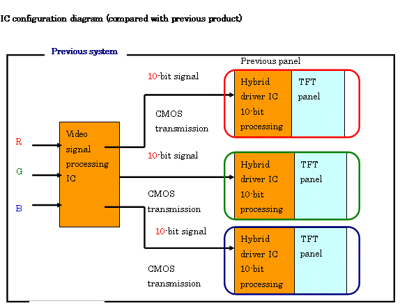

The new panels also use 12-bit LCD drivers which boost accuracy in reproducing subtle differences in color and gradation. The previous model's 10-bit driver was capable of controlling 1.1 billion colors, but the new 12-bit driver is capable of controlling 64 times that amount at 68.7 billion colors. The new panels also quadruple gradation approximation from 1,024 gradation levels to 4,096 gradation levels. As a result, the new panels offer high quality images that are ideal for wide-screen, high-definition products.
In addition, various improvements have been made to make installation easier for product manufacturers, such as boosting noise immunity by utilizing mini-LVDS* interface and strengthening panel tape (FPC).
*The LCD panel's differential signal interface is called mini-LVDS.

- Improved color reproduction by using a 12-bit LCD driver.
- Improved noise immunity by using a Mini-LVDS interface.

| LCD driver | 10 bit | 12 bit |
| Video signal transmission | CMOS | Mini-LVDS |
