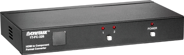

TV One task’s newest format converter, the 1T-FC-326, allows the user to take either of two HDMI inputs and convert it to Component Video. Very wide video bandwidth ensures that the analog output is capable of showing the fine detail present in most HDMI signals. The audio output includes Coaxial Digital and Analog Stereo (R/L) that is de-embedded from the HDMI digital signal stream.
The 1T-FC-326 is compliant with HDMI 1.2a, HDCP 1.1 and DVI 1.0. It supports all HDTV and SDTV resolutions. The unit may be operated from the front panel buttons or the IR Remote Control. LEDs on the front panel indicate which of the two inputs is selected and if HDCP (Content Protection) is present. It accommodates cables with either standard or locking type connectors. Provisions are made for securing locking type HDMI connectors to the case.
The unit requires external 5VDC and an AC Adapter is provided. It has a locking DC connector for added security. The unit has a recommended retail price of £149 (€220) and is available to order for an immediate delivery.
