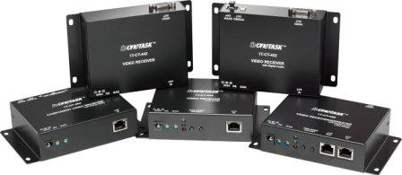

TV One-task is unveiling eight new Cat.5 models. The 1T-CT-400 Series is a comprehensive system for the transmission of RGBHV or YPbPr video at resolutions up to 1920x1200 and 1080p, plus digital or analog audio signals over Cat.5/5E or Cat.5 cable at great distances. The mix and match approach to the product line enables the user to choose the most cost efficient units to perform a specific task. Three transmitter models are available, two models handle RGBHV and one handles YPbPr format. Five Receiver models continue the theme of flexibility and enable the user to choose the distance, output type and audio capabilities if needed. All Items are available for immediate shipment.
The three transmitters are capable of distances up to 300m (1,000 ft.) Two models provide analog and digital audio capability. Two models handle RGBHV and one handles YPbPr format. Five Receiver models continue the theme of flexibility, allowing the selection of the appropriate unit to provide distances of up to either 150m (500 ft.) or 300m (1,000 ft.) Choose models with or without audio as the application dictates. The long range models have built-in RGB Skew Compensation adjustments. The 1T-CT-456 has a built-in UTP Repeater that allows another receiver to be cascaded up to an additional 300m (1,000 ft.)The specifics of each model are listed below:
1T-CT-441 - RGBHV In via HD-15 w/Loop-thru, Range to 300m
1T-CT-443 - RGBHV In via HD-15 w/Loop-thru, Analog Stereo In via 3.5mm or S/PDIF Audio in via Toslink, Range to 300m
1T-CT-453 - YPbPr In via 3 RCA, Analog Stereo In via 3.5mm or S/PDIF Audio in via Toslink, Range to 300m
1T-CT-442 - RGBHV Output via HD-15, Range up to 150m, Equalization and Gain Adjust
1T-CT-444 - RGBHV Output via HD-15, Range up to 300m, Equalization and Gain Adjust
1T-CT-452 - RGBHV Output via HD-15, Range up to 150m, Equalization and Gain Adjust, Analog Stereo In via 3.5mm or S/PDIF Audio in via Toslink
1T-CT-456 - RGBHV Output via HD-15, Range up to 300m, Equalization and Gain Adjust, Analog Stereo In via 3.5mm or S/PDIF Audio in via Toslink, Built-in RBG Skew Comp, Built-in UTP Repeater Output
1T-CT-464 - YPbPr Output via3 RCA, Range up to 150m, Equalization and Gain Adjust, Analog Stereo In via 3.5mm or S/PDIF Audio in via Toslink
