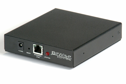

The BC4 system is made up of a base unit and various expansion I/O modules available from BitWise Controls. The base unit is housed in a rugged steel enclosure (4.5” x 5” x 1”) which contains the built-in network adaptor and temperature sensor. It can be powered by 802.3af PoE or a standard 12VDC wall supply. Field-upgradeable firmware allows the BC4 to take advantage of future enhancements, and the on-board temperature sensor allows the host control system to monitor the ambient environment. It automatically recognizes and adapts to various I/O plug-in expansion modules, which become an internal part of the base unit. The base unit can be wall or shelf-mounted, or up to 16 BC4 units may be rack mounted in a 3U space.

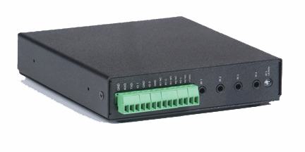

Each expansion module is individually configured to perform a variety of control and monitoring tasks. The first available expansion module is the BC4-BCX1, which features five IR (infrared) ports, one three-wire RS232 port, two customizable GPIO (general purpose input/output) ports, and 2 SPDT relays. An extensive on-board IR code database with built-in IR learning makes the BC4-BCX1 an extremely fast and efficient way to add IR control of connected hardware. IR signals can be routed to any or all of the 5 IR outputs – 4 standard 1/8” jacks for off-the-shelf emitters and one built in IR Blaster. The two GPIO ports can be individually configured as digital inputs, digital outputs or analog inputs. One input can also be configured to monitor signal frequency (up to 50 KHz) or as a counter input. The three-wire RS232 port can be used with their available virtual com port driver or via communication over TCP.
