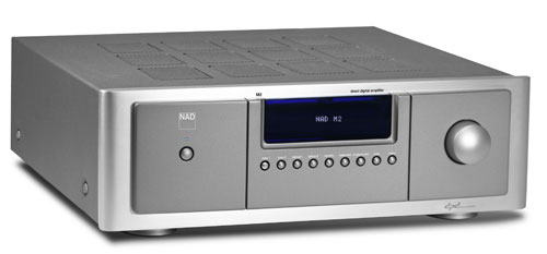

NAD Electronics, the highly regarded manufacturer of high-performance audio/video components, introduces the Masters Series M2 Direct Digital Amplifier, delivering in the culmination of a decade long research project a new level of amplifier performance. Immensely powerful, dynamic, efficient, and musically revealing, the M2 is a true digital amplifier that sets new benchmarks for both measurable performance and subjective musical quality.
Superior to any previous digital amplifier, the M2 can be thought of as a Digital-to-Analog Converter (DAC) that directly drives a loudspeaker, but with the same precision as the very best low-level DACs. The M2's technology is far more sophisticated than the Class D analog amplifiers that are often erroneously referred to as 'digital.' In fact, the M2 is the first digital amplifier that can match the best linear amplifiers for low noise and distortion, delivering better than Class A sound with Class D efficiency. At the same time, the M2 is capable of delivering startling power, 250 Watts to each of two channels at 4 or 8 Ohms continuous power, and 500 Watts IHF Dynamic power.
