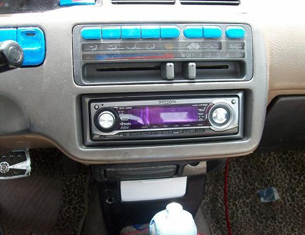

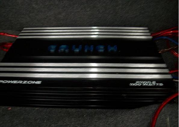

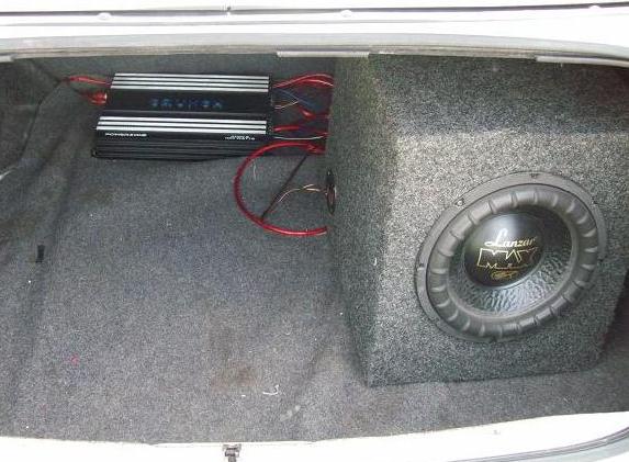

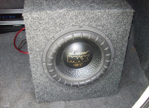

Here it is, ain't too much but it works good enough for me. Below are pictures, descriptions, and what I paid for it all.
Head Unit KDC-MP335 ($100 out of box sale)
Amp and sub, kinda sloppy right now.
1100 Watt 2 channel Crunch Amp ($140)
800 Watt Single coil 10 inch Lanzar Max
S/T ($60 with the box)

do you have good results from that Crunch and Lanzar? is that a Crunch P1100.
2?
Username: Jayhunter
New Haven, IN
Post Number: 18
Registered: May-08
It sure is! The Crunch and Lanzar work together like bread and butter.

u got taken on that crunch man. that lanzar's not great but for 60 bucks not bad ether. crunch have a bad rep on these forums.
Username: Jayhunter
New Haven, IN
Post Number: 21
Registered: May-08
Really? My buddy has one and he hasn't had any problems yet. Hey I guess it's better than a Sony Xplod huh?
