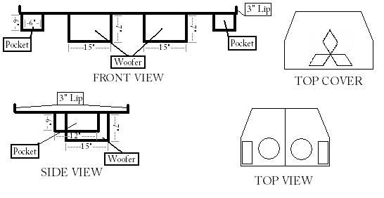

Username: Tycoonbob
Ky
Post Number: 243
Ok, so I been tinkering with a new idea...and its a totally redesigned box. I feel like an indecisive girl. =/
Opinions on this?
It will cover the entire trunk, but will initially still give me a trunk, just not as deep as it used to be. I will have the top cover lay over the top, and have the Mitsubishi logo cut out of it and have a mesh grill behind that. There will be little pocket compartments on each side, basically for fun. The box will still be sealed...but the top part of each sub box compartment will be the big top panel piece that covers the entire trunk. Amp would mount on the REAL trunk floor, and is accessed by lowering the back seats.
If any more clarification is needed, LMK.
Username: Ducka
Houghton and/or Macomb, MI
United States
Post Number: 770
no, not really... I would assume that it is no larger than 0.07cuft.
Username: Tycoonbob
Ky
Post Number: 244
hmm, maybe it is supposed to be 0.03 and im just doing my math wrong.
Username: Ducka
United States
Post Number: 772
i would say somewhere between there and 0.07
